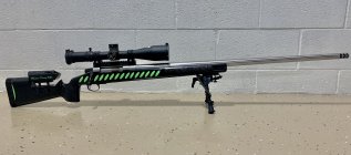

Can you show me a pic of this drop in the case?
Cool Gun............:cool:
it’s sentimental to me, I was fascinated with it from first sight at my gunsmiths back in 2010 when I was 18 and getting into long range. Fast forward, I was given the opportunity to buy it 2 years ago and I did so with zero hesitation.
It is Kevin Cram of montour county rifles old hunting rig, it has killed a pile of deer and larger wayyyy out there.
I knew that I had seen that rifle before. It was on his avatar on a forum that I do not visit anymore.
