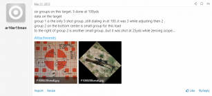

this is a massaged 91/30 oem bbl like new condition
shortened to 24" threaded with a brake
reconfigured oem stock, sanded and stained
usgi m14 cheek pad stained
timney trigger
bipod
6-18x nikon
project was to disprove collector claim that 91/30's were 3 moa rifles and no BUBBA work could make it better
at 100 yards, 3 shot load development.
150 hndy hunting bullet .3xx
168 308 smk .5xx
174 312 sie ..........0.257

i cannot find the sie 174 gr target
this is the first hornady 150 gr 312
groups are marked 1 -5, large group on upper left is zeroing scope.
really small group on lower right is three at 25 yards.....knew it was going to be a shooter.
velocity and loads listed in upper right. 100 yds less the 3 at 25
Did you have another screen name? I was just glancing through some of the Mosin posts and the target looked familiar...haha!
yes that was in another life...look at the date...2013.
i use to compete in mil surplus rifle match at 100/200 and 300/600 sniper matches. 30'06,8mm, 7,5x55 swiss, lots of various mn's russian, polish, finn..etc.
