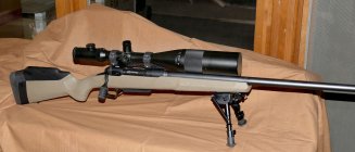

Got it broken-in and sited-in.. Got to Ben Avery for 3 hours and shot 18 trios.. Had trouble siting-in with the rail on backwards and couldn't see the bulletholes @ 100 yards. :-( Got a little frustrated until I remembered I had a NightForce 12-42X56 scope at home to use. Reloaded more ammo, turned the mountplate around, installed the NF...
