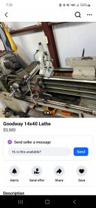

Pretty hard to say from one picture.
Lathes like that go for crazy prices up here, so it looks like a decent deal to me.
Machines that have run with water based coolant can get ugly looking. It might not actually be that bad.
Check the condition of the cross slide ways, and the lengthwise ways right in front of the chuck. If those look decent, I would try it out. VFD's are cheaper, better, and easier than ever. Automation Direct is a great source.
Like Western Oklahoma, the Texas Panhandle is pretty much a "machine desert". Local pricing will be higher than other locals. It's a trade off sometimes,,,, out right price or transportation. With just a 3 jaw chuck, a spider could be built for the chuck end, and certainly a spider would be needed on the outboard end, if the headstock is short enough. A lathe can build many things, not just chamber barrels. Check what has already been mentioned, length of the headstock, overall condition of the ways in particular. Be best to check under power. Does the coolant pump work? I see no tool post of tool holders in the pic, another expense.. Note that new tool posts usually come with an oversized T for the compound slot, and you'd need some way to make that fit properly.

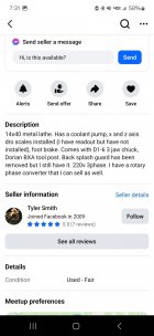

Notice is says, "fair condition". Could mean anything, the paint, or mechanicals. It also say, "make an offer". Ahhhh, says it comes with a BXA tool post. That's small for that sized machine.
