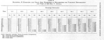

According to The University of Illinois annealing study 30 seconds at 450C (= 842F) gave a slight hardness change. I believe these were 1/8" thick plates cold rolled to different degrees of cold work and annealed in a furnace. Again if your seeing red you are annealing to the temp almost everyone agrees on. If you anneal much longer beyond first seeing red you are approaching getting to hot.
