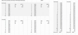

Please explain why you accept this as valid when the two groups were shot with different guns. Even though he claims the guns are identical, presumably I build specs, I have trouble believing they shoot identically.
Because I merely looked at the data. I didn’t know they came from two different guns. I didn’t even watch the video. Not sure why anyone would post annealing vs not annealing data between two different rifles. That obviously is like comparing an apple to an orange.
Dave
While two different guns can certainly be and issue and call into question the validity of the test, as it has, given the knowledge, expertise and history that Lou Murdica has, I'd give him a lot of positive weight to his claim that his two guns shoot the same (not that the claim is an absolute). ¯\_(ツ)_/¯
