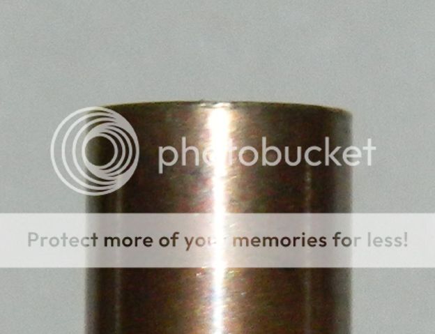

CTR Case in Photo
The scratches always start at the neck opening and run most of the neck sized length.
There is a bright area at the neck end where each scratch starts. Did a brass burr break off at these locations?
Rt Case in Photo
Looks like one tiny brass particle at the case mouth from when the case was extruded at the factory? It’s about the size of the bright spots at scratch beginnings in your center case image.
Enlarge the posted pix (seven clicks with “Control +) and you can see these areas.

Suugestions here led to solution…
A bit fuzzy (microscope camera thingy is busted / won't work w/ new 'puter) but image shows a "rolled over" case mouth. How they do that, I don't know… but loading procedure for new cases now includes chamfering in/outside necks.

Looking at your pix of a single case. The ridge at the case mouth is probably from trimming to length at the factory?
