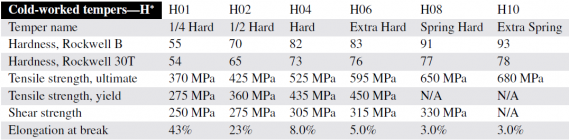

See if these tables help visualize the properties of the brass a little.
This one shows the relationship between the amount of cold work versus the other properties.
Notice the elongation at break numbers and how fast they change with cold work, as well as the yield strengths. Those elongation at break values basically illustrate the ductility.

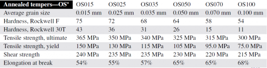

This next table also shows what happens as we anneal that brass. This isn't a perfect representation of the values of a thin neck, but come close.
Again, you will notice that as the hardness changes with the annealing temper, so does the grain size and several other properties. Note the yield strengths how much more they change compared to the ultimate.
Cartridge brass is almost perfect for our purposes.
Where on your tables was Cartridge Brass?
I don't see the alloy identified, and all the numbers change from C24000 to C28000.
That said, I agree with you.
