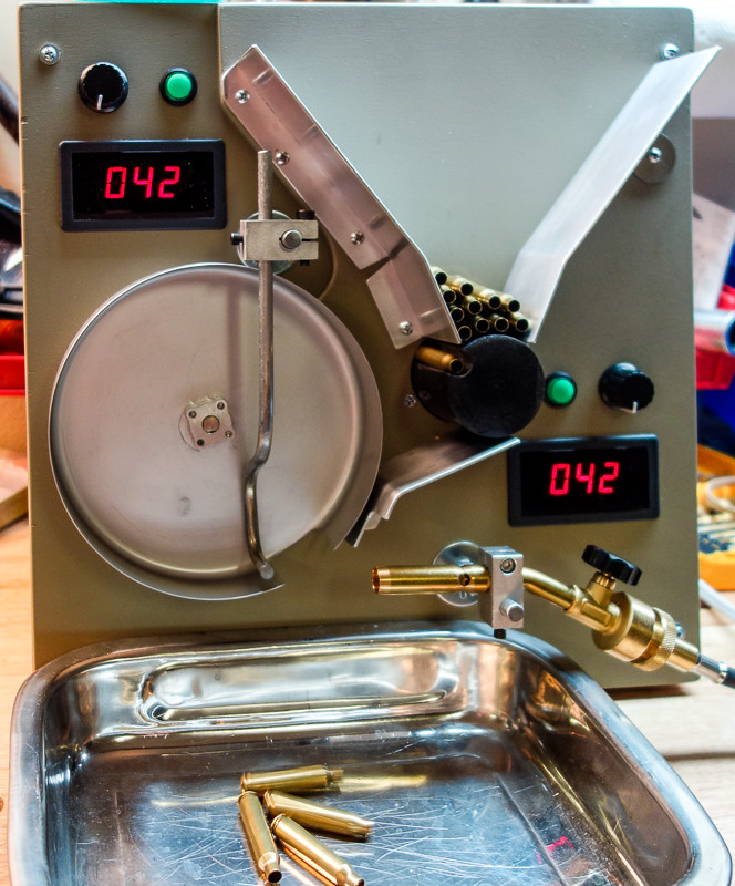

I've responded over on the WTB/WTS section about a Annealer that I use and love to run. It's the MRB Annealer which is priced reasonably and functions without a hitch. Oh, and BTW, this Annealer has a no BS warranty which is what sold me on the unit. It's a complete unit, unlike the Annealeez which requires "extras" to run short and long brass, and at additional cost.
Give it a look, I think you'll be impressed with the quality and performance.
http://www.mikesreloadingbench.com/
I'm not affiliated with the company at all, just a satisfied customer.

I've also have the same annealer. After 3 months I can see no reason to get rid of it!!
