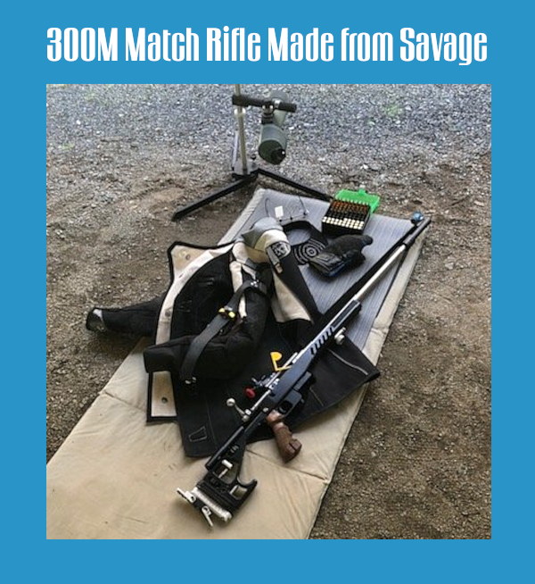

So, I began the project of building a 300M International competition gun, about a year ago, intending to compete at the 300M National's this year in Minnesota @ Minneapolis Rifle Club.
Realistically, I didn't want to pay the pricetag demanded of the Bleikers, Grunig & Elmigers, Hammerli's, or Tanners that (infrequently) pop-up for sale from time to time.
I had decided on .260 Remington as the caliber choice - beating out 6.5x47 Lapua simply due to the cost/availability of brass. I made my first batch of brass by necking down some Federal .308, and it worked great.
I had an older Savage M12 stagger feed action, that was originally a BVSS in 22-250. I contacted James @ Northland Shooter Supply, and he walked me through the game plan & equipment I needed: A Shilen Select Match 26" barrel, an NSS Stainless recoil lug and nut, a set of Forster headspace gauges, and the NSS action wrench.
A few months later, I replaced the original Accu-trigger, with a Rifle Basix SAV-II trigger, and immediately wondered why I waited so long to do that - it's perfect for my application. The safety DOES NOT work - but, I don't need it for my application.
Another member here sold me a BVSS stock that has been re-worked by Alex Sitman of Masterclass Stocks, and it served as a placeholder, until I could find a maker who could nearly replicate my Feinwerkbau 2700 Alu stock in my smallbore match gun.
After scouring this forum, and multiple internet searches, I happened upon PDC Custom, in Michigan. I spoke with Craig Kierstadt a few times, before finally deciding to pull the proverbial trigger on his chassis. He happened to have a few of the older stagger feed action spacing chassis' left, and he machined an Anschutz rail into the fore end for my hand stop & sling, powder coated it black, and sent it to me sans a grip & butt plate (I had ones I was planning on using already). There are a few minor issues with it - overall, i would rate this a 9.5 out of a possible 10. The price, and the features built into it, plus the ease of which everything fit together, far outweigh any minor issues, and two of the issues I had, are already corrected with three pieces of teflon tape. I will need to make a walnut cheek piece - a curved one isn't conducive to aperture iron sight shooting.

Here are the particulars:
Savage M12 stagger feed action, 4.27" spacing
Shilen Select Match Barrel, 26", chambered in .260 Remington Match
Rifle Basix SAV-II Trigger
PDC Custom Chassis, with tool-less adjustments
Walnut Target grip for AR-15, off of eBay
a MEC Spy Long rear sight (German)
a Centra front sight tunnel & adjustable aperture (German)
a MEC handstop/sling swivel (German)
a MEC Contact III Butt plate (German)
a Bobsled SLED for single loading as required by competition
a Medesha sight extension tube & collar
a Champion's Choice front sight base,
a Champion's Choice mirage band.
The practice load:
.260 Remington Hornady brass
Hornady 123 ELD-M
CCI - BR2 primer
H4831-SC @ 42.0
The results:
25 shot initial prone test today shows promise. There are 5 sighter shots, and 20 record shots. One of the 9's @ 9 o'clock is my first sighter, the other one I own. The high 9 @ 12 o'clock is a cheek pressure issue. The 8 out @ 4 o'clock was a round that was difficult to chamber - I should've ejected it, and tried another round, but things were going so well - oh well. my initial scoring puts me somewhere in the vicinity of 193 - 7x. My match load should shoot mildly better, I'll know more with a little practice.

One more shot of the action/chassis - it locks up really tightly, and you can tell Craig spent some time on the CNC work need to make this all fit:
