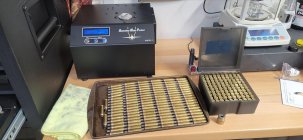

Any issues with putting an Amp annealer next to upper end scales? Even if scales are unplugged? Damage?
So how much distance is needed between annealer and high end scales? Anyone know?
Perfect the answer I was looking for. Thank you! I had read at 1 time Not to run induction tool near a pacemaker, and it got my wheels turning on the delicate scales and their electronics.
I’d personally position them a minimum of 3ft apart. The magnetic field is primarily contained within the coil but there is no telling how well the electronics inside the unit, driving the coil, are isolated. No sense taking any chances with a precision scale.

I've got 4 to 5 feet. Keep scales unplugged and run on a flash fish, however magnetic fields are different. I keep thinking EMP, BOOM, another $1000.00 dollars. A Cards comments eased my mind a bit.
