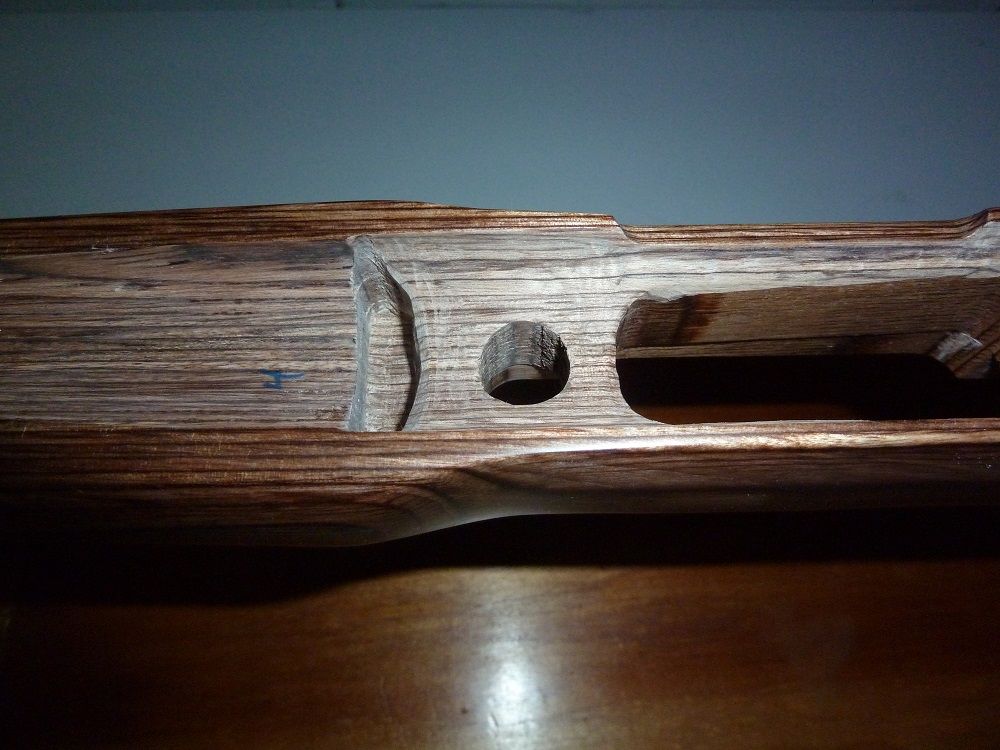

I elected to to install a single shot follower in place of the flimsy magazine. I filled the magazine well in the stock with clay and left it there when I put the Devcon in place. I used G-10 for the pillars. It is a "plastic" material that is quite strong. I had to redo the first process as the front by the barrel nut cracked. I only re bedded the lug portion.
Hopefully, the pictures help to illustrate what I have put to print. I found that you have to remove a lot of the bedding material after it is cast. I used electrical tape to put a front rest on the barrel so it will hold the proper angle when finished. I did the "mating" upside down and wound electrical tape around the action. I did not like doing the operation blind and would do it right side up next time. The Devcon is heavy enough to do it this way.

I relieved quite a bit of material before bedding and used the electrical tape to support the barrel for the second point of contact.
I'll include pics of my before and after first bedding job on a Rem 700.
Before bedding but after relieving stock areas.
[URL=http://s860.photobucket.com/user/jepp2/media/Before_zpsu5epxavw.jpg.html][/URL]
After bedding and cleanup
[URL=http://s860.photobucket.com/user/jepp2/media/After_zpsafqwt3x6.jpg.html][/URL]
