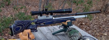

Here's my favorite. A RAW(Rapid Air Weapons) TM1000 in .177 with a 4 ounce trigger wearing a Mueller 8-32X44 . Also my set up for shooting off a bucket & sticks. I can shoot out to 65 yards sitting in my garage or 100 yards from my side yard.
