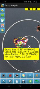

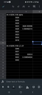

My results have been excellent so far. Attached is a chronograph comparison with Lake City LR I did last weekend while sighting my Palma Rifle. The last 6 shots went into a ½moa group, with iron sights and on a windy day too.
