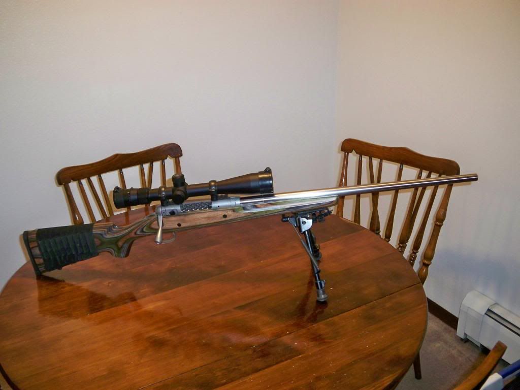

Almsot complete 243win for Varmits/Deer
scalian
Banned
Stainless Short Action timed and trued by SSS
SSS comp trigger
NSS Lug
SSS fluted bolt
SSS Tactical Bolt Handle
Stainless Trigger Guard
24" CBI light varmint barrel
Boyd classic stock pillared and bedded with Devon
Harris bipod with pod lock (probably remove it and use sticks)
Burris steel bases and signature rings
Vortex Viper 6.5x-20x44
So far worked up a load shooting 87 vmax that is constantly in the .3s to .4s. Have some 95 Nosler BT and Berger 105 vld to work up a deer load.
Waiting for the Vortex Viper HS-T in MOA to release for final scope. Want something with a lower end power range. Then need to figure out what to take the shine off the stainless with. Debating media blasting it or sending it in to Black Ice for coating with Teflon. For now it will just get a little camp foam tape wrapped around it.
My go to antelope/deer loads in my Savage .243 are with the 95g Nosler HBT & the 85g Sierra GKHP...cant be beat IMO.
Others to give a try 80g barnes tsx/ttsx, 90g swift (419 BC)., 85g nosler partition.
They all shoot under moa from 100 - 400 yards.
Media blast will make the barrel match the action...am surprised your gunsmith didn't tell you about it before he finished the barrel...knowing it was going to be a hunting rifle..
Eddie in Texas
Great job and a real nice looking rifle. Does the time and true really make a difference?
Thanks, The time and true did significatly lighten up the bolt life on my rifle. It seems that some start out harder than other and ymmv. I had good luck sending my action to SSS sent it in when they said they were ready for a batch and had it back in about a month. I was prepared to wait much longer from what i have read.
