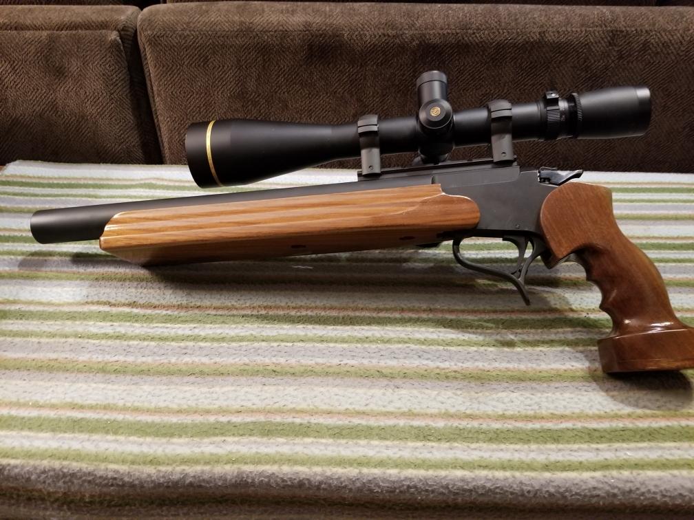

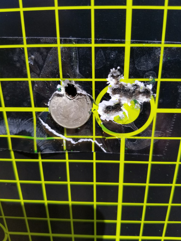

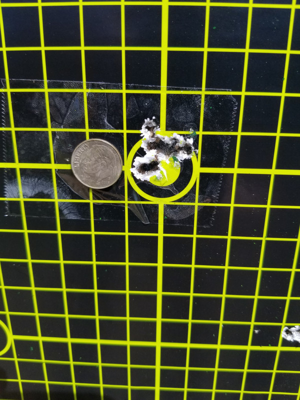

I built one about 10 years ago on a R700 FB action, Lija 12-twist, 3-groove barrel and HS Precision PSV 096 stock. It's on the heavy side so it's not a walk-about rig for me. I use Nosler 32gr boat-tail BT [purple tip], Rem 7 1/2 primer, H4198, RL7 or AA2200 all work very well for me. Fortunately for me, 17 FB brass was available at the time so I purchased several hundred cases and prepped them all.
Mine consistently shoots sub 1/8 MOA [HORZ & VERT] groups @ 200 yards as long as I do my part. You won't go wrong with a PACNOR barrel either. I just re-barreled my 30-06 with one and I've been pleased with it thus far.

Have you seen my thread from a ways back:
55gn Berger and flirting with 1” groups at 600 yards even after 2000 rounds down the barrel. It has to be the most satisfying rifle I’ve ever shot. It is so consistent.
EDIT: tell me this doesn’t make you rethink what’s the minimum needed for long range accuracy:
Evan, excellent LR performance from that little FB case.
But I must ask, why choose the 55gr bullet for the 20VT? Just to shoot paper?
With the loss of velocity with such a heavy for caliber bullet in such a small case, terminal effects on small varmints in the field must be lacking.....no aerial performances?
IMO, the 32gr bullets just seem tailored for the 20VT, but maybe it's just me.
