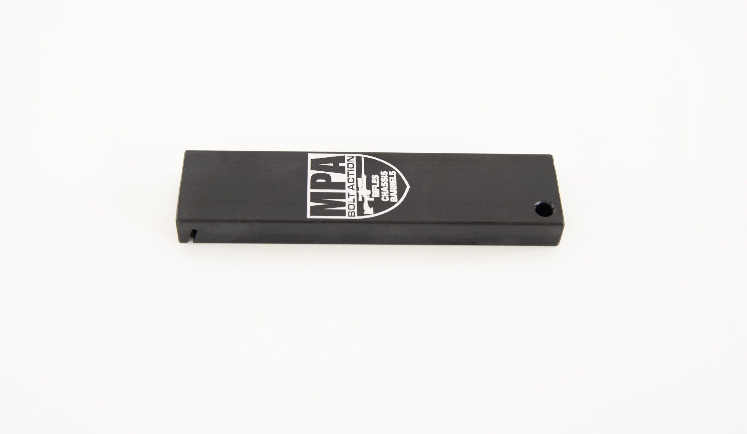

Can you recommend a feed lip tool that works well?
Using calipers, compare the feed lips front to back with your 5 round mag. I'm guessing you'll need to open the front of the 10 round a small amount.
@ShtrRdy the MPA tool works well, here’s a link.
A little tweak goes a long way.
Sounds like a lip got dented during shipping or somewhere along the way. Easy fix with the tool, I guess. I’ve always been cheap and used pliers.
All of my AICS .308 mags need lip adjustment. I used the MPA tool to fix the lips I screwed up with a pair of pliers, (as chin hits chest in embarrassment)..... They work just fine now.
