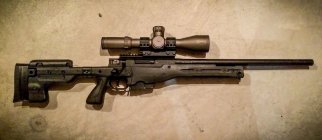

I'll chime in once I've ran a few tests and let you all know how I'm doing. Here's a pic of my new rifle.
Your scope looks like it might be mounted a bit too far forward. Try moving it back about an inch or so and see how that works for you. Pick up the target adjustable butt pad that will increase your LOP.
Congrats! You'll love the AT and its ability to quickly and easily swap barrels.
