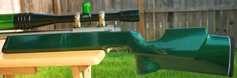

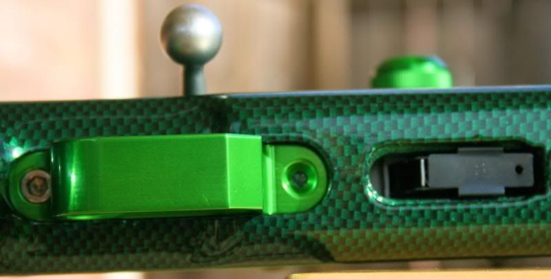

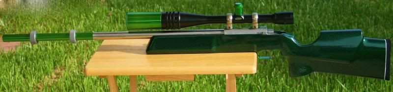

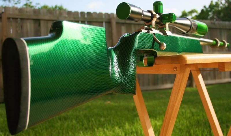

Single shot..Jewell BR trigger @ 2oz..Picatinny rail 0 degree..2 groove Benchmark....Edge stock..T36 weaver 1/8 dot..Some old Eley 10x... Von Ahrens tuner with 6" bloop tube..
Patti - Does it hold the minute of tree accuracy pretty well? ;D
Really hope to go with a repeater rather than a SS action.
