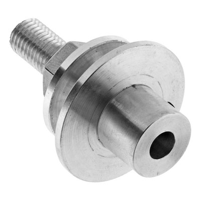

Great Planes Set Screw Prop Adapter 6.0mm to 5 16x24 GPMQ4942 Spinners & Hub
This would be to hold the part that rotates the cases
Get one for the shaft diameter of the motor you wish to use if not the motor listed

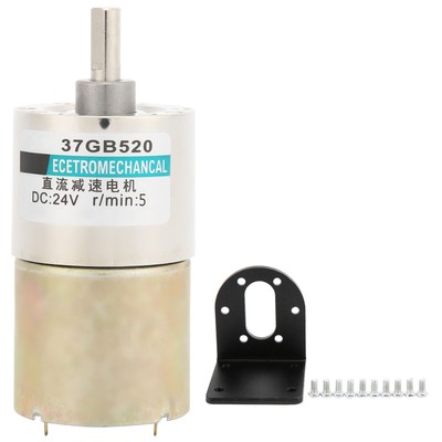

Greartisan DC 12V 10RPM Gear Motor High Torque Electric Micro Speed Reduction Ge (1 unit)
https://www.ebay.com/itm/153880730770 $20.00

DC Reduction Motor with Bracket CW/CCW Large Torsion forCNC Machine Tool 24V/12V 12v 10 rpm

Great Planes GPMQ4945 Set Screw Prop Adapter 8.0mm to 3/8x24 1 piece
https://www.ebay.com/itm/353775994043?epid=1400185183&hash=item525eb144bb:g:Lw4AAOSwNLthjSd0 $11.58

Greartisan DC 12V 30RPM Gear Motor High Torque Electric Micro Speed Reduction 1 unit
https://www.ebay.com/itm/353809032364?hash=item5260a964ac:g:3pQAAOSwNNJhtj2d $25.83
