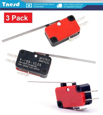

MINI CONTACTORS
these get put in line with the case drop to stop it when it reaces the vary top or bottom
Pics available once I have them installed
