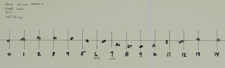

I'll post this, as I have before. It represents very well how I establish a setting as well as why..with my tuner. This is a short range cf rifle and the test was not shot by me. It's quite typical except most rifles show a little more muzzle deflection and clarity. This is generally relative to bbl stiffness. He did the test very much like I asked and it tells me exactly what I look for from it.
See that sine wave and group SHAPES? That's what I look for, almost perfectly.
