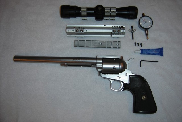

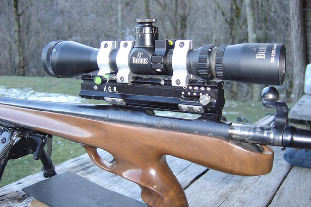

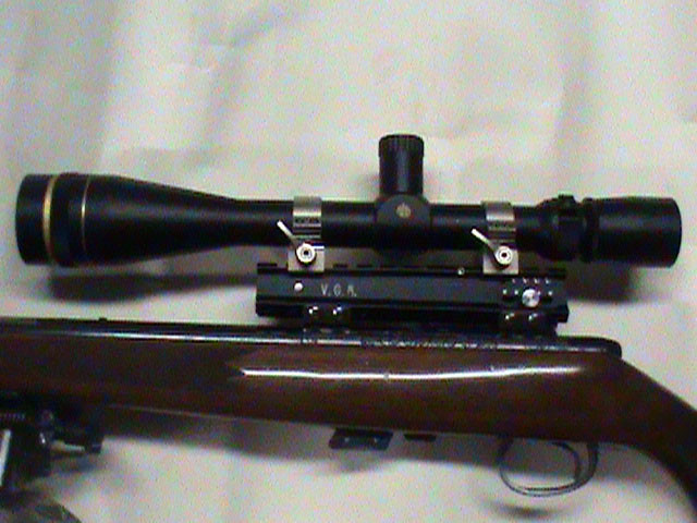

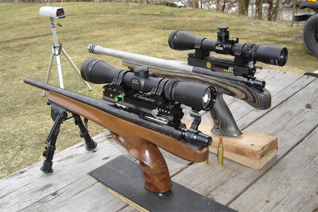

When I first started shooting the 1000 yard steel plate matches at Rayners when they first ran them there were three of us that were old IHMSA silhouette shooters and wanted to use pistols for the matches. I still had two old XP-100 bolt action guns in 260 rem and 7-08. This was about 8 or 9 years ago and everyone was still trying to figure out what worked, I put Burris 12x pistol scopes on mine with a VGM mount made by Chris Self in Selma Alabama.
https://www.fieldandstream.com/blogs/gun-nut/2009/12/petzals-miracle-scope-base
Told him what I was wanting to do and he'd never heard of putting one on a pistol but was interested in seeing how it would do. His mount has 5 positions you can preset with a dial caliber using calculations. He also made me one of his very limited 10 position mounts contoured for an XP action. Initially I had first position set for zero at 100 yards, position 2 at 250 yards, position 3 at 500 yards, position 4 at 750 yards and position 5 at 1000 yards. Then use sub-tensions in scope for the in between distances.
Later on I switched to rear grip chassis and SWFA 5-20HD rifle scopes and was able to dial any distance even out to a mile with the 6mm and 6.5mm calibers. I later used them on my longrange rimfires and also a Freedom Arms 44 mag I was experimenting with for really longrange experimentation.
It was very precise and well built, would always be spot on when put into any of the preset positions. It was sent with about 120moa of travel but with a slight bit of machining near the back pivot pin it would be capable of 240 moa of travel.
Chris is retired now and no longer makes these. I don't think there are many out there. It's built like a tank, the only problem that he said he's ever had was the one on my Freedom Arms 44 mag. It actually started to strip the grooves where the pins hold it to the picatinny mount. He had me send it back and custom made me a SS one that matched the gun with additional pieces that fit the grooves perfectly to lock it solid.
He's had these on 50 BMG rifles but the recoil on the revolver was harder on it than the big rifles. After the modification it's held up perfectly with no movement and exact settings when I slide it to various positions and tighten the lock. I have it set for 100, 200, 300, 400 and 500 yards preset positions and with the 2 1/2-8 Leupold with custom turrets lets me dial all the in between distances.
One day at Rayners I hit 4 out of 5 on a standard IPSC target at 500 yards, my Son duplicated that and Tom, the owner of the Range also hit 3 out of 5 at that distance. JD Jones has shot it and made hits at 500 yards, he'd never seen one of Chris' mounts but had worked on a similiar design for his SSK company but never put it in production.
With the modern scopes of today and for most applications this type of mount isn't needed even to a mile but for distances way out there is would be a good option to really stretch it out. I think more manufactures are making adjustable mounts so there may be other options but back then there weren't many and this one filled my needs and did it very well.
