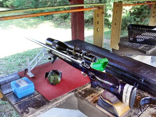

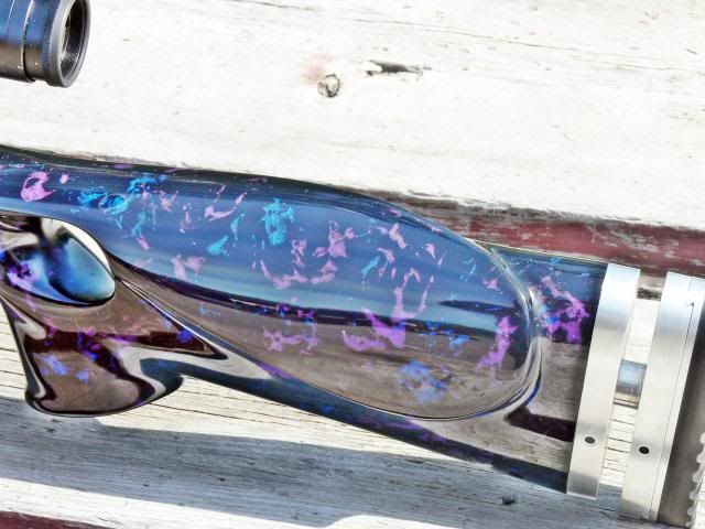

Here is friends 223 in a savage action (sans nut) he uses for FTR
Savage
Tru-Flite 1/7 F class contour at 30"
Robertson Composites stock Thumbehole
NF 12x 42x benchrest
168,547
2,257,742
81,390
