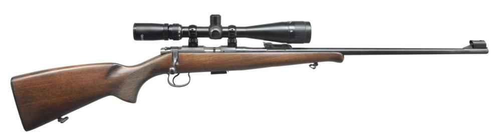

This is what mine looks like.
This is the 452 American

+1^^ I have the 452 Lux like the one you have pictured above. Love that thing. The one I have is accurate above its price point. Squirrel hate that thing. :D;)
