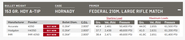

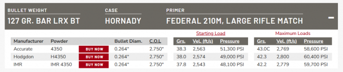

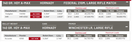

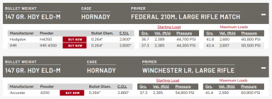

Here is a few screenshots from Hodgdon's data...
