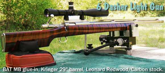

My problem is I'm from the old school when rifles were almost as much about good looks as accuracy. There was nothing like the look of a Sako deluxe, or Weatherby, or Colt Sauer in fine walnut.
How about a Terry Leonard-stocked light gun? Carbon fiber under that beautiful veneer.
