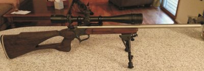

mine is a .222 Rem mag Imp by Bellm
a real shooter for sure
21" Bbl tapered (my first wildcat cartridge circa 1987)
