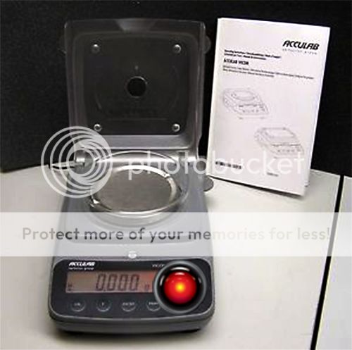

I've had my acculab sartorius scale for many years. (about 10, I think) Probably weighed 60k-80k charges on it. until two weeks ago, every one of those charges ended with an even number in the "hundredths column". i.e. .x2 .x4 .x6 .x8 .x0
suddenly, on feb 6 for no apparent reason, i threw a charge that read 36.47 grains. I was so surprised, I even took a picture of the scale, which I can post if needed. And trickling up and down it clearly was measuring .46 .47 .48 but no other odd number. e.g. not .45 or .49.
a few days later, the scale started reading lots of odd numbers. not all of them, but quite a few, and it stopped displaying the next higher odd number. so for instance, if you were trying to hit .48, you could trickle up from .46 to .47 and then it would skip .48 and .49 and jump to .50. this lasted maybe a week.
today, it has returned to normal, only displaying even numbers.
I haven't cycled the power on the scale in a few weeks. I'm fairly confident the scale is weighing accurately, as I chronographed my match load twice and both times got a 4 fps ES.

A lot of scales are setup to only give even numbers. The idea behind this is the rounding of the number will reduce the flickering the user will see between odd and even numbers and so give the impression of a more stable response (yes it’s psychological…).
Most scale that does this is set to do this in their setup menu. If your scale changed this by itself, then it maybe that it got zapped by a surge or static and some items in the menu was inadvertently changed. The best way to deal with this is to first turn it off and back on, look up in the instruction to see if there is a way to “reset” the scale back to factory specs.
This is THE reason why you don’t leave the scale on when you are not using it. Learn to turn it off when not in use to protect it from line surges and only turn it on an hour or so before use – it’s plenty to allow it to warm up and stabilize.

Wow, I've never seen that before on my Acculab.
I think you could probably sell it and make a profit. After all, your scale just doubled in precision capabilities going from 0.02 grains precision to 0.01 grains precision. :)
Has your scale developed a red eye and started talking to you?
"Just what do you think you're doing with that powder charge, Dave?"
"I'm afraid that's too much H4831, Dave. I can't let you shoot that."
"I'm worried about your ES, Dave."
