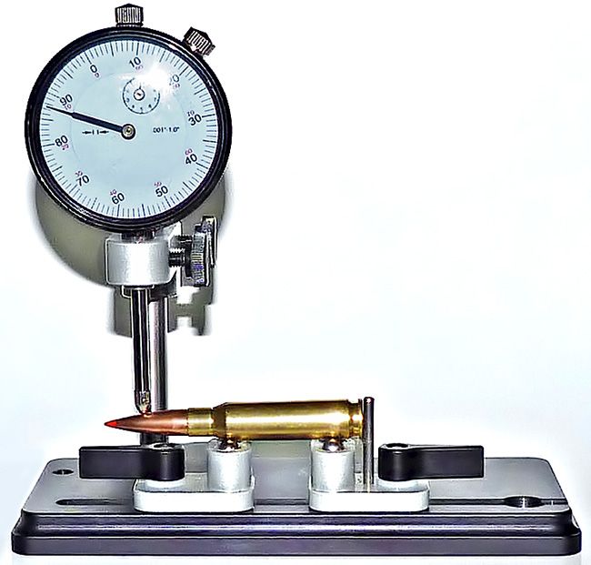

It seems like everyone has a different opinion of how to measure runout. I do it like you said here. Half way out to the tip. If the bullet is seated a little off, it will show here. I like to see no more than .001" total runout, .0005" per side. I keep anything up to .002" and the rest are used for fouling shots or pulled apart and redone. This is a 208 grain A-Max in Lapua brass showing where I measure. I use a modified Forster Benchrest full length die (with a floating expander ball) and usually have .002" interference fit in the necks. The ball does not pull the necks out of alignment. I use a Redding Competition seating die. On these 208 grain rounds, I load them hot and reduce the neck tension to about .001" with a K&M expander for neck turning. This tool never seems to hurt the runout.
