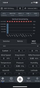

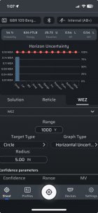

Excited about the WEZ feature. Went through the Manual and watched the video's. It's great to see what changes impact Accuracy. I'm having one issue though I'm hoping someone can help me. Temperature seem's to dominate my WEZ. Even when I have all my Confidence factors to Zero (wish there was a reset option). Even when I have my temp/wind down to zero my Vertical uncertainty is always huge...like 26 MOA. And my Horizontal Uncertainty looks off too. Even when I have zero Temperature it shows up as a major uncertainty contributer. What could I be missing?
My Simple thinking was make all the variables zero then see what impact each one has independently???
Also, It would be nice if the Confidence factors were saved independently for each profile. That way I can profile different guns.
TIA

Excited about the WEZ feature. Went through the Manual and watched the video's. It's great to see what changes impact Accuracy. I'm having one issue though I'm hoping someone can help me. Temperature seem's to dominate my WEZ. Even when I have all my Confidence factors to Zero (wish there was a rest option). And I have my wind down to zero my Vertical uncertainty is always huge...like 26 MOA. And my Horizontal Uncertainty looks off too. Even when I have zero wind, Temperature show up as major uncertainties. What could I be missing?
TIA
In this case I would try:
1) Delete the app
2) Restart the phone
3) Reinstall the app
This will reset everything for you. This clears the cache out.
