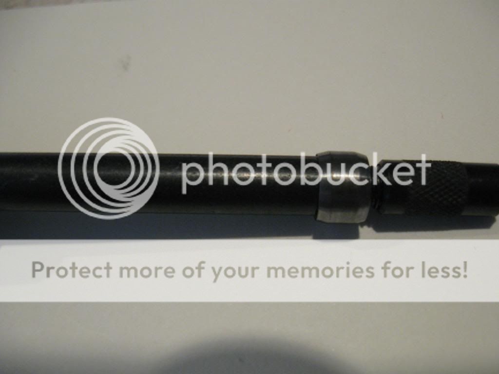

bigedp51 said:
This picture illustrates perfectly why I went to the carbide expander ball.
My cheap camera doesn't do the finish total justice. It's actually smooth enough I can't feel any drag at all when I pull a fingernail across it. It appears to have a 20 micro-inch or less finish on it.
amlevin said:
I was referring to the roughly made threads and tooling marks on the decapping rod assembly, this could cause the rod and expander to be tilted off center.
