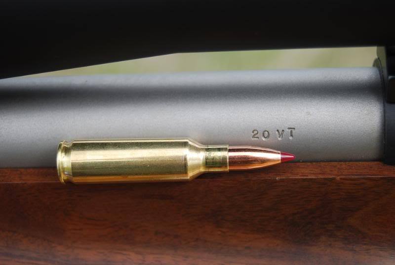

JSH, as you have not decided on the exact case yet, I'll throw in a strong "plus" to go 20VT. As has been said, forming from 5.56 is really not an issue unless you don't have the time or are just lazy. There are other good options of course, but the case volume vs. bore diameter are just about perfect for this little gem. There is good availability of 221FB brass from Nosler most of the time if you can't find Lapua or R-P.
Miserly on powder, see all your hits/misses, wicked accurate, absence of recoil and muzzle blast and terminal performance on rodent sized targets to 500 yards. My "long shot" on squirrels at present is 509 yards.
It even "looks right"......
I really like the fact that the 20VT gives right at 3,800 fps w/32gr bullets from only 18.5~grs of powder. It really is "miserly" when compared to any larger case. Good stuff....you need one.

I'll have to go with the 20VT also, its my favorite out of all the 20's I have and forming brass wasn't really all that bad,
a couple of winters ago I formed 2000 cases from LC13 brass in a couple weeks, I have also used Norma and Lapua 221 brass but prefer the LC reformed brass.
I use R-P .221 FB brass (not impossible to find) in my 20 VT, shoots in the .2's, little recoil and even less throat wear. All you need inside 300 yds. I know other shooters take them farther out, but this is the majority of our PD shooting and we have bigger rounds for the longer shots. Also have a .20-.222 and like it, but caliber specific dies are much more expensive than ones for the VT. Our VT reamer is no turn neck; I also don't like turning a large volume of necks.
