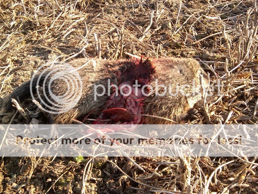

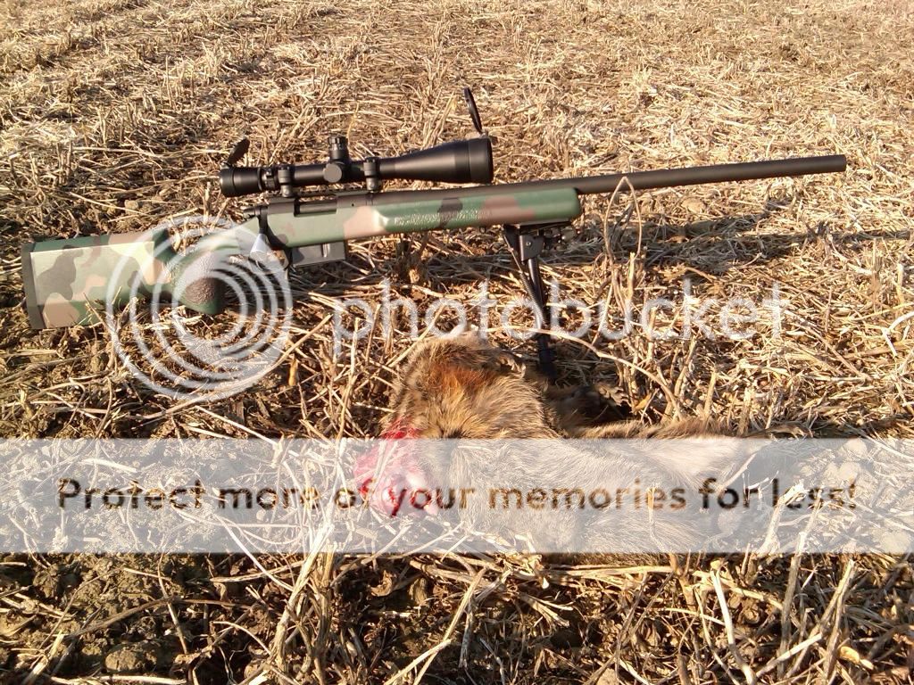

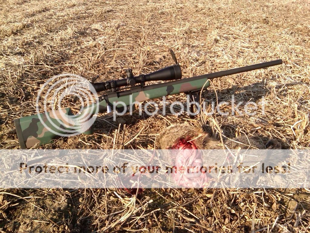

Well, here is a few pictures of 42 Gr of RE-15 and 168 gr A-Max's out of my 308. It did a pretty good number on this Ohio woodchuck.
