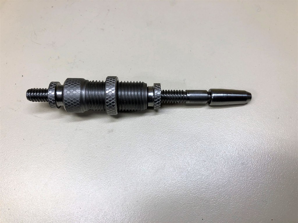

Ok, I'm a bit confused. I just got a Whidden .308 click adjustable FL bushing die also. The expander, if you want to call it that, only measures .305 so it's not touching the neck at all. I'm using a .334 bushing and the necks post sizing are exactly .334.
Expander ball kit.
The correct size expander can be used with a bushing die. Best used with unturned necks.
No issue with that. its just going along for the ride. I am just going to remove it since its not needed. My underlying question was if I'm neck sizing why would I need an expander ball.

It appears to me that Whidden just puts a small diameter expander in the die to hold the decapping pin more than anything else. I'm decapping in a separate operation. I left the expander in mine since it's not doing anything anyway.
If brass is not outside neck turned, the bushing pushes neck wall thickness irregularities to the inside.
Light contact from an expander moves them to the outside of the neck, where they belong. Only takes very light contact.
