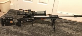

PVA does a great job on prefits. I have one they did on my .308 on a TL3 action in the pic below. Highly recommend them.
Not sure if you know or not but you can use TL3 prefits on the Origin also if you use the Hunts Long Range lug. Well worth the $35 if you have both or just can find TL3 prefits.
