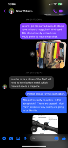

No. This is specifically for the CMP Vintage Sniper matches. Rules state that the M40 must have bottom metal, but a single shot action is acceptable. So it's just a cosmetic feature to fit the rules.
Yeah I understand. My photo is of my stock for my personal M40 for VS.
In speaking with BW at the time he told me single shots were never used and therefore it had to be a repeater and use a magazine.
Believe me, I like your way a whole lot better.

So...how does a single shot receiver fly in this format?????
The match is fired prone from front sandbags all single shot with timed target exposure (20 seconds) at 300 and 600 yards. Absolutely no need for a magazine unless you want to use the rifle for other purposes.
But as Aaron said, the rules are somewhat vague and open ended. Ppl have built rifles in good faith only to be told be CMP armorers that the rifle is illegal in their interpretation of the rules.
Take for example in this category - the statement any 3-9x40 optic will be accepted…. Well this was true until CMP saw that I planned to use a Vortex Diamondback Tactical with turrets and a TMR reticle… the rules were modified then to reference an additional rule in the rulebook about reticles. Turrets I was told have to be capped but I know of instances where Leupold optics with CDS elevation are being used.

So there's no written rules that it must be a repeater? But it has to have repeater bottom metal?
