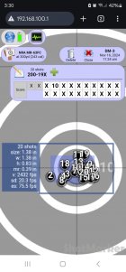

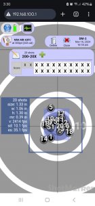

A friend of mine just shot a 300yd 600-59x

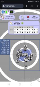

@F Class John. Thank you for the kind words. Was an intense day of shooting for sure. Shot #2 on Match 3 is going to haunt me for awhile!
First and foremost, Great Shooting!!! What was the speed of Shot #2? Perhaps you could ask the Match Director.... >30 ES and single digit SD doesn't seem to matter as much as we think......

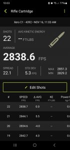

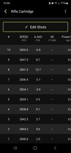

I have nothing to blame but myself for shot #2. Wind was changing from left to right, I saw the let up and just did not give it enough value. Based on my Zero chrono readings, shot #2 was 2838 fps. Data from shootmarker does not seems to correlate well with chronograph data
