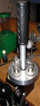

I currently use my Harrell turret only for neck expansion/seating force measure. What I felt was a weakness in the design was the bushing/bolt holding down the turret plate. This allows enough play to turn freely turn the plate through each detent, but it also allows the plate to lift in use. The lifting plate set's the die off from true perpendicular. There is no need for this really, as turning the plate from detent to detent is fairly infrequent. Yet, it sucks to keep an allen wrench around to tighten the plate rigid with a thicker bushing(the allen bolt bottoms early) for each turn to new die.
So I setup a threaded handle to loosen for plate turning and then lock the plate down. This also gives me a leverage handle to hold with any heavier use of the press(the flimsy bench clamp can't be relied on for any real work).
