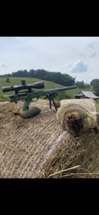

Is that a regular XP-100 action or a Rem 700 action?
Can you give us a side photo of your specialty pistol.
Pat I absolutely love that SP,it suits me fine right down to that fat barrel with the tiny bore.The stock color is the spitting image for the Tracker on my 20 Dasher rifle too:)
Great shooting too keep it up.

The 14/221 Walker is the 221 Fireball case necked down to 14 . It took me about 15 years to finally get this project up and running . A lot of set backs not being able to get materials and things . I’m sure it is a process of making the brass . But i have a gentleman i feel makes them cheap enough i don’t bother . In this short barreled pistol i get 3759 FPS with a 15 gr bullet . I really love it have taken close to 170 chucks with it .

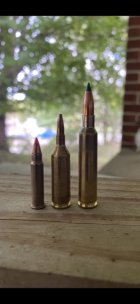

Never heard of a 14 caliber before, Interesting! How about a pic of a loaded round next to another case for scale?

Here is a picture of the 14/221 Walker cartridge . Cartridge on the left is a 17 HMR , middle cartridge is 14/221 Walker and cartridge on the right is a 20 Tactical . This XP weight is around 10lbs. . Barrel is 17” long and it wears a Leupold VX-3i LRP 4.5-14X50 with Impact 32 reticle . My furthest shot with this rig on a chuck is 254 yards .
