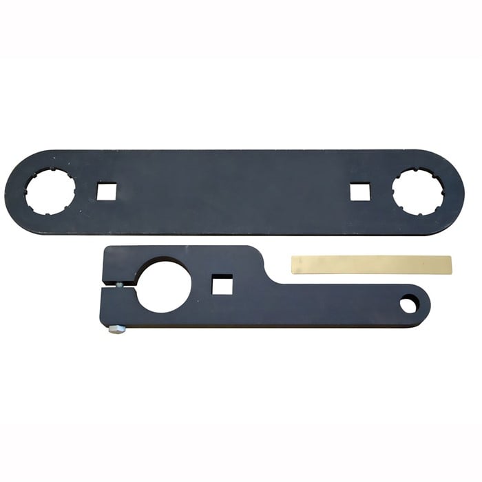

To me, that story just reaffirms that there's no substitute for the correct tools.
Don't know if that "gunsmith" charged you to scrap your action. But an action wrench(or barrel vise) and a barrel nut wrench would have been cheaper than replacing the action.
If you use a barrel vise, is a rear entry action wrench enough to do the job since the barrel vise is doing the holding job anyway?
No, on a Savage action the priority is to make the damn barrel nut move from the recoil lug because the assembly torque puts the barrel threads under tension.
Forgive my basic English.
So it definitely takes the outside action wrench to do the job then?
I am just trying to learn about the barrel nut process.
Yes, some kind of wrench, be it the Wheeler or my Frogenstein, is necessary, while you maintain the action with a vise secured rear entry bar that locks in the bolt lug recesses and you have the option of an action wrench on the barrel.
For the reverse operation, you need a a GO gauge and/or an empty case.
I have heard that rear entry action wrenches have a history of twisting Savage actions. Never used one myself.
I prefer the NSS or Wheeler action wrench over a barrel vise. If the action threads get blueing salts or bead blast media in it, the barrel can be a little sticky coming out. With the action wrench, just keep unscrewing the nut and it'll take the barrel with it.
