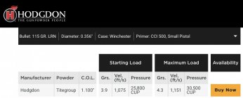

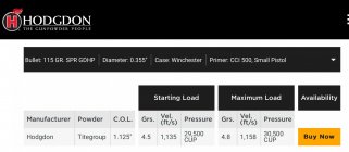

Looking for suggestions, 9mm subsonic using 115 bullets titegroup powder, shooting my 3" springfield armory subcompact, how many grains?need a starting point then I'll do some chronograph testing.

Going subsonic with 9mm is nothing, considering subsonic is 1125 fps and under. I guess it depends on how low you wanna go. I load 3.6.g Tightgruop w/125g coated giving me 1060fps out of a 4.6 in barrel, 1.100 OAL. Been a long time since I loaded 115’s, can’t remember what I used. 3.2g w/147g coated is what a couple of buddies use.
I’d start in the middle of your load data and work your way down, until your gun starts to have reliability issues. Then bump it up .2-.3g. That’s if you want to go as low as you can and still be reliable.

If I remember correctly they average about 930-940 ish fps (I don't have my notes handy).
These are velocities from a 4” bbl; your 3” bbl may get you below the 1,125 FPS threshold without cycling issues with the 115 jacketed/plated bullets.
Using powder coated bullets as JT27’s Buddies do, you should have little to no problems using Hodgdon’s data here as well.
