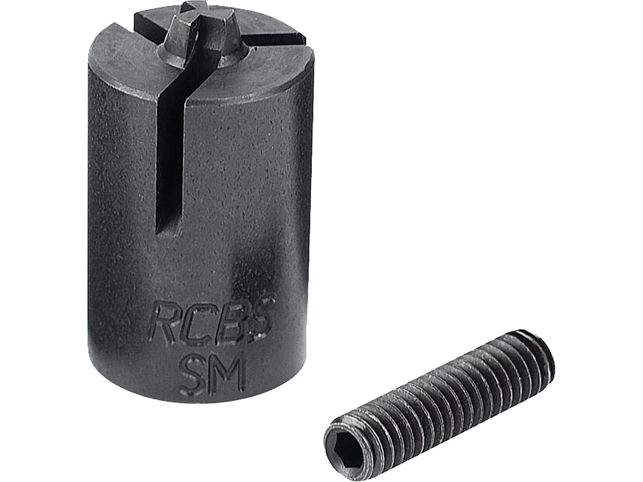

I do not like to use this tool on rifle brass because I believe it removes way too much material in my opinion but the Hornady Primer pocket crimp cutter tool works wonders for low pressure pistol brass. I chuck the cutter up into my drill, mounted on the bench and go through 1000 pcs as fast as you can touch the brass to the tool and drop. It's that simple.
Dan
It's worth it to me to put in the work, removing the crimp is simple, I cut the crimp out with an RCBS crimp cutter running on the Lyman case prep, no big deal, sort the brass by head stamp, very easy to distinguish the crimped cases, then lube and into the Dillon.
