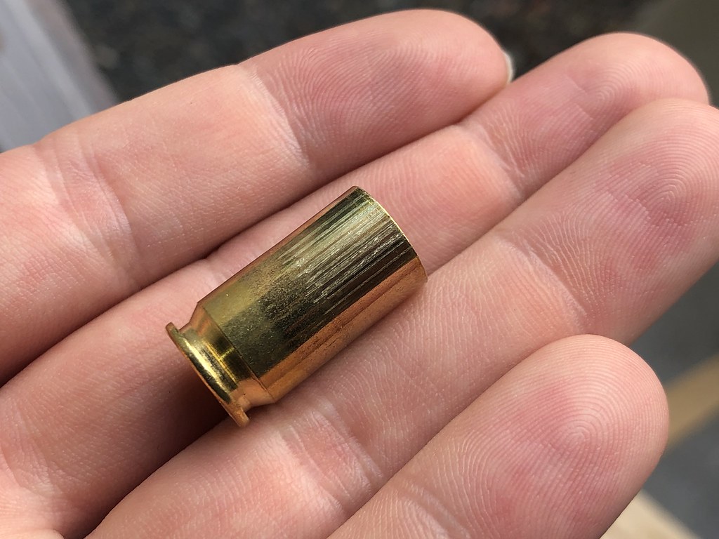

Do not size any cases until "ALL" the brass is removed from the carbide ring. All it takes is for some grit to stick to the die and start picking up brass.
You might have to polish the carbide ring with Flitz, J&B bore paste or automotive rubbing compound to remove any embedded grit.
The polishing compound from your walnut tumbling media can stick to your carbide die.
You can use a snug fitting shotgun cleaning mop chucked in a drill and any of the polishing compounds I mentioned above.
Below a carbide die scratching and galling a .45 ACP case. so you are not the first person to have this happen.
