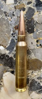

Standard reamer lets me seat them before jam, just like this. The 95’s have a long body. The VLD 90’s are the Moly bullets in the center.
The light in this bottom picture reveals the relative body better without my estimated indicators.

FWIW - I found very early on that the 90 VLDs in my setups shot well at ~.018" to .024" off the lands. So that's where I have always seated them, rather than into the lands. The unfortunate part about that is that the PTG .223 Rem ISSF reamer that cuts 0.169" freebore was designed in conjunction with shooters that were seating the 90 VLDs as far as .010" into the lands. So one way of looking at it is that by seating 90 VLDs around .020" off the lands, I just effectively gave up about .030" worth of the freebore cut by that reamer relative to the folks seating them .010" into the lands.
In my hands, the 90 VLDs seated at around .020" off the lands in a brand new barrel chambered with the .223 Rem ISSF reamer (0.169" fb) have the boattail/bearing surface junction right at, or just barely above the case neck/shoulder junction. That is part of the reason why I had a .223 Rem reamer made that cuts 0.220" freebore. Seated at the same relative depth, the 90 VLDs have the boattail/bearing surface junction something more like 1/4th of the way out the neck. In a .220" fb chamber, the 95s seated at -.024" have the the boattail/bearing surface junction well below the neck/shoulder junction (see attached image below). The alignment in the image is far from perfect, but it should give a rough idea of where these bullets will be seated in a chamber of given freebore.
Given where each of these bullets is situated in the case neck when seated at -.021"/-.024" in a chamber with 0.220" fb, you could easily extend the freebore by another .050" (i.e. 0.270" fb), seat either bullet at those respective seating depths, and still have bullet shank gripped by at least half of the neck (or more). With the 95s, the BTO dimension (average of 10 bullets from a single Lot#) is ~.064 longer than the 90 VLD, the BS dimension is ~.057" longer. Depending on how little bullet shank in the neck you were willing to accept, you could probably even use a .300" fb and still seat the 90 VLDs with the 1/3 shank gripped by neck. I personally prefer not to seat bullets that far out in the neck, but you could if you wanted to and it would probably work just fine.
