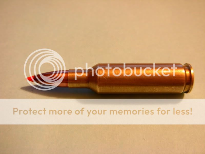

95 V-max 39.5gr Varget CCI 450 Small Rifle Mag. primer 3240fps.
cloverleaf groups.

Nosler 100 gr. ballistic tips, CCI 450 primers, 40.0 grs. of RL-15, and an OAL of 2.700".

With 95vmax the best I found was 43.7 h4350 oal 2.525 sub moa at 3150fps in 26inch barrel. FWIW a crow shot with this leaves a splash over a 4ft area.

Hornady 95 gr. V-Max, Re-15 39.5 gr.
Length base to Ogive 2.078”
Vavg = 3178 Vhi = 3191 Vlo = 3159 Sd = 15 Es = 39.2
