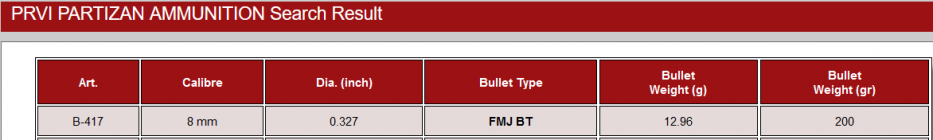

Prvi Partizan makes the proper bullets, and Grafs has them. For some reason they’re listed with the rest of the 8mm bullets. The ppu catalog number for them is B-417.
