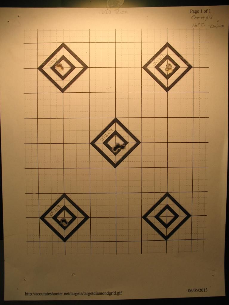

I've been using 8208 for some time now with 52 gr. Bergers. The attached target was shot last month with my stock 1:9 twist Savage Model 12 LRPV. They are all three shots at 100 yards using 24.6 grains of 8208 and Br4 primers with Winchester brass. The barrel continues to foul more than a near-sighted batter after more than 2200 rounds but keeps on going.
