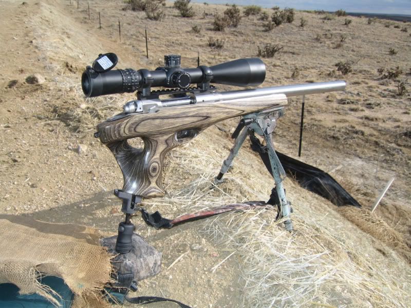

I'm running the 80 out of this oddball Savage Super Striker 22-250, 8T McGowen @ 2850 using old IMR 4350. Actually won the www.moaguns.com field shoot this year with this setup--
