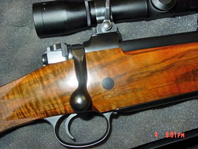

I make toys out of them. The first is my small ring 7x57 Mexican mauser.

Butch, could you email or post some pictures of the Mexican 7x57? I have a Mexican action and looking for ideas on what to do with it. I'm old school and love Mauser's. Thanks nerosirrod@hotmail.com
The first picture on the first page of this thread is my Mexican. I do have more, but they are on a different computer.
